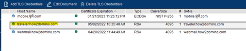

First, you need to have a certificate store database (certstore.nsf) – it will be created by default, or you can create the same using certstore.ntf. Make sure that the certificate store (certstore.nsf) is created on the admin server. Open the certificate store and you will see the existing TLS certificate details as shown below.

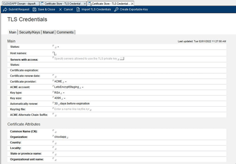

You will be prompted with the window below where you will be providing the required details to create the certificate.

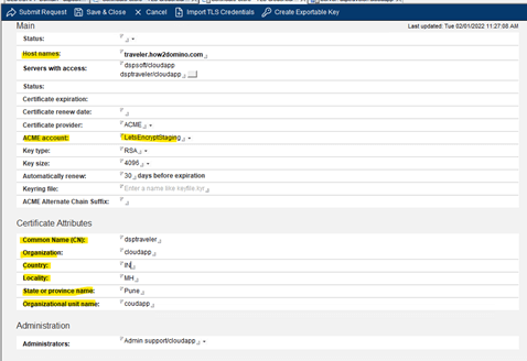

You must provide the Host names (mostly your host server name).
In this example, we set the ACME account as “LetsEncryptStaging”, a non-production server performing the challenges.
You can either choose RSA or ECDSA based on your requirement. Based on your environment provide the certificate attributes.
How to Secure Domino Using Certmgr Task
Once the required attributes are provided, you can submit the request.

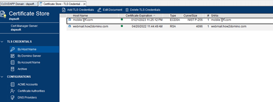

After the request is submitted, you can see the new certificate request in the database which is yet to be processed as shown below.

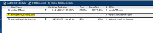

The certmgr task will initiate the request and perform the challenges with the Let’s Encrypt server.
If the challenges are performed and completed, you will see the status as below.

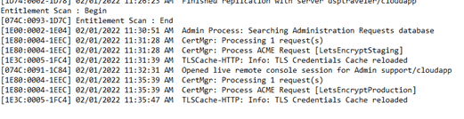

You will see the status below and it should allow the certmgr to process the request.

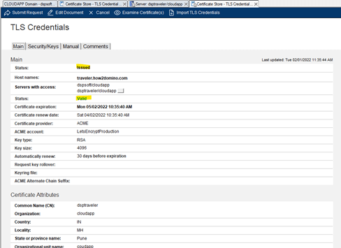

You can check the status in the database once the request is processed—the status should be green.
If there is any error message or if any challenges failed, you will see the status as red. You can also verify the error message in the request.
The processed request will be as shown below, where the status will be issued and valid as shown below.
