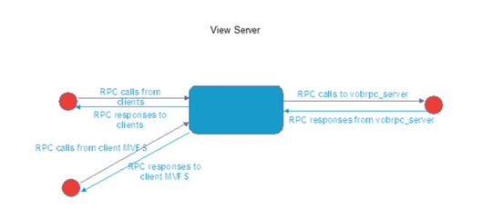

In a typical HCL VersionVault transaction, either the MVFS or a client will send an RPC to the view server.  The view server, in turn, calls an RPC on the VOB server.  The response must first come back to the view server, and then a second response is sent back to the client.
view server
This process has two layers of RPCs, each with a call and a response.  If you have network latency of 10 ms, then this particular transaction will require 40 ms.  Although that may not seem like much time, it quickly adds up.  A check-out operation may involve more than 200 RPCs, as HCL VersionVault authenticates the user, verifies the license, locates the VOB, locates the view, and so on.  So, in this case, even with relatively good 10 ms latency, over the course of the entire operation HCL VersionVault can spend more than a second waiting for data to arrive through the network.
